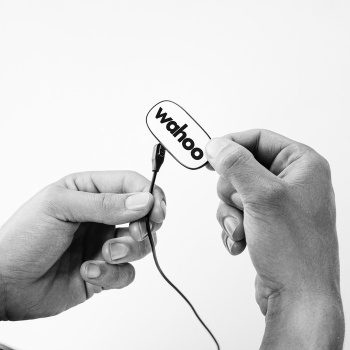

  • Rechargeable, no coin cell
    A built-in battery recharges over USB-C to a magnetic induction point, and runs for up to 100 hours per charge, so there is no fiddly coin cell to pop out and replace.

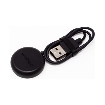

  • Up to 30 hours, rechargeable
    A rechargeable battery clips on to charge and lasts up to 30 hours, enough for weeks of typical training between top-ups.

Recharge USB-C to Magnetic Induction Point USB-A to Charging clip
