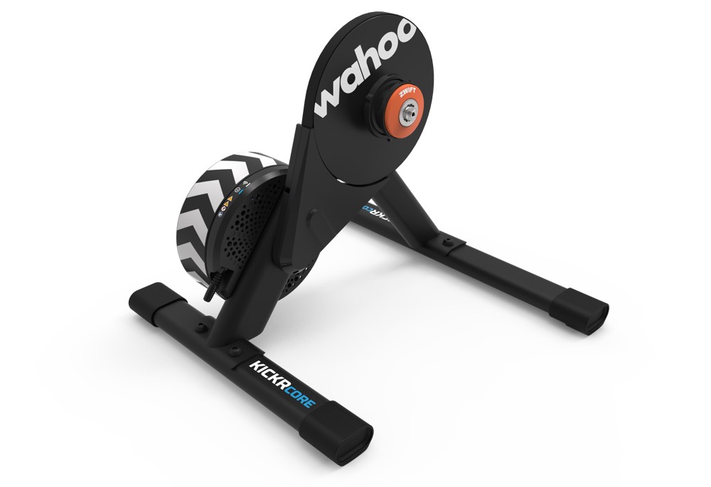

Zwift Ready
  • Zwift Click controls your virtual gears from any handlebar
  • Precision flywheel technology matches resistance to the grade of the virtual road
  • Power Accuracy: +/- 2%
  • Maximum Power Output: 1800W
  • Some assembly required
  • Zwift Cog comes pre-installed
  • Fits 130/135 mm QR, 12x142 and 12x148 thru axle; adapters and hub spacers included
  • Zwift Click runs on a CR2032 battery and pairs over Bluetooth
  • Check bicycle frame compatibility

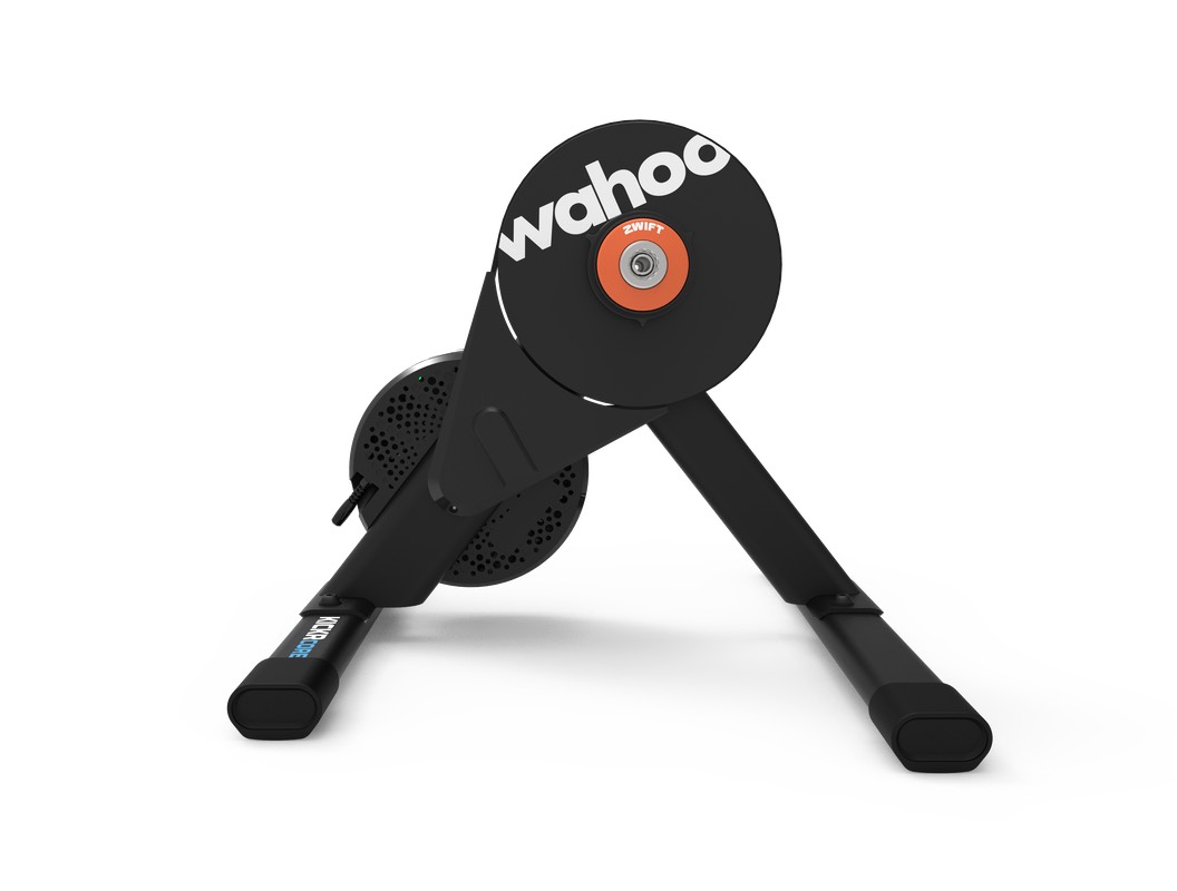

Zwift Cog fits almost any 8-13-speed bike, keeping maintenance to a minimum—just jump on and start riding.
Flexible, easy set‑up
KICKR CORE 2's simplified four-bolt assembly and color-coded leg components streamline setup and ensure a secure, stable build for your hardest sprints.
Real Ride Feel
KICKR CORE 2 uses precision flywheel technology and advanced algorithms to automatically match resistance to the grade of the virtual road—so every climb and descent feels real.

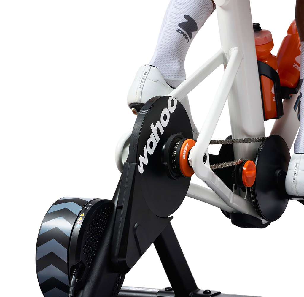

Virtual Shifting
Zwift Click controls your virtual gears and attaches seamlessly to any handlebar, turning your bike into a smart bike with quiet, smooth, and consistent shifting.
Your ride. Your way.
KICKR CORE 2 with Zwift Cog and Click accommodates almost any 8-13-speed bike to maximize compatibility and minimize set-up. Whether you have multiple bikes or multiple riders, this is a seamless solution to get everyone in the house Zwifting.

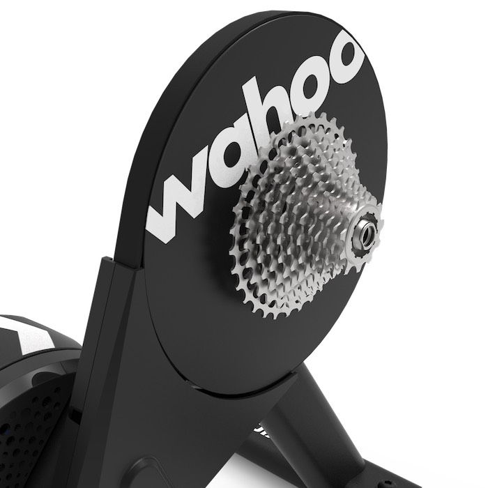

Designed for versatility, the CORE 2 works with most road, gravel, and mountain bikes, ensuring seamless integration into diverse setups. Out of the box, it supports Shimano HG freehubs for 8–12 speed cassettes, with optional freehub bodies for SRAM XD/XDR or Campagnolo (excluding Shimano Micro Spline and Campagnolo N3W 13-speed). It comes in three configurations: with an 11-speed cassette, with Zwift Cog and Click for virtual shifting, or cassette-ready. Hub support includes 130/135mm quick release and 12x142/148mm thru-axles.
