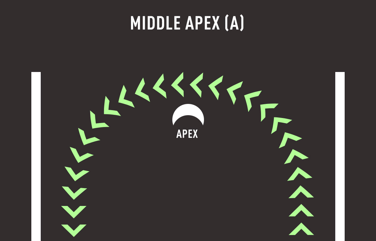

The apex in the middle of your trajectory. (A)

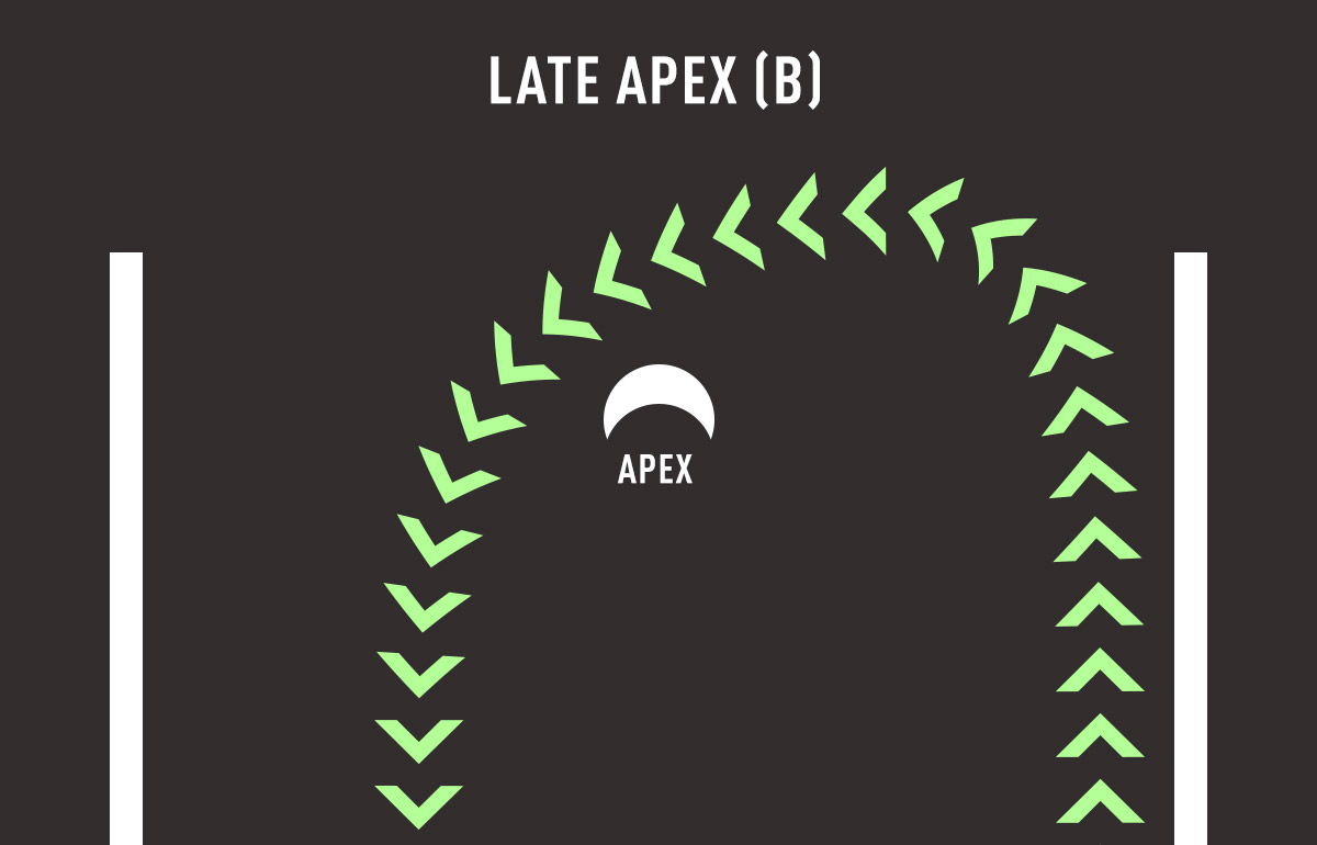

The apex on the latter part of your trajectory (B)

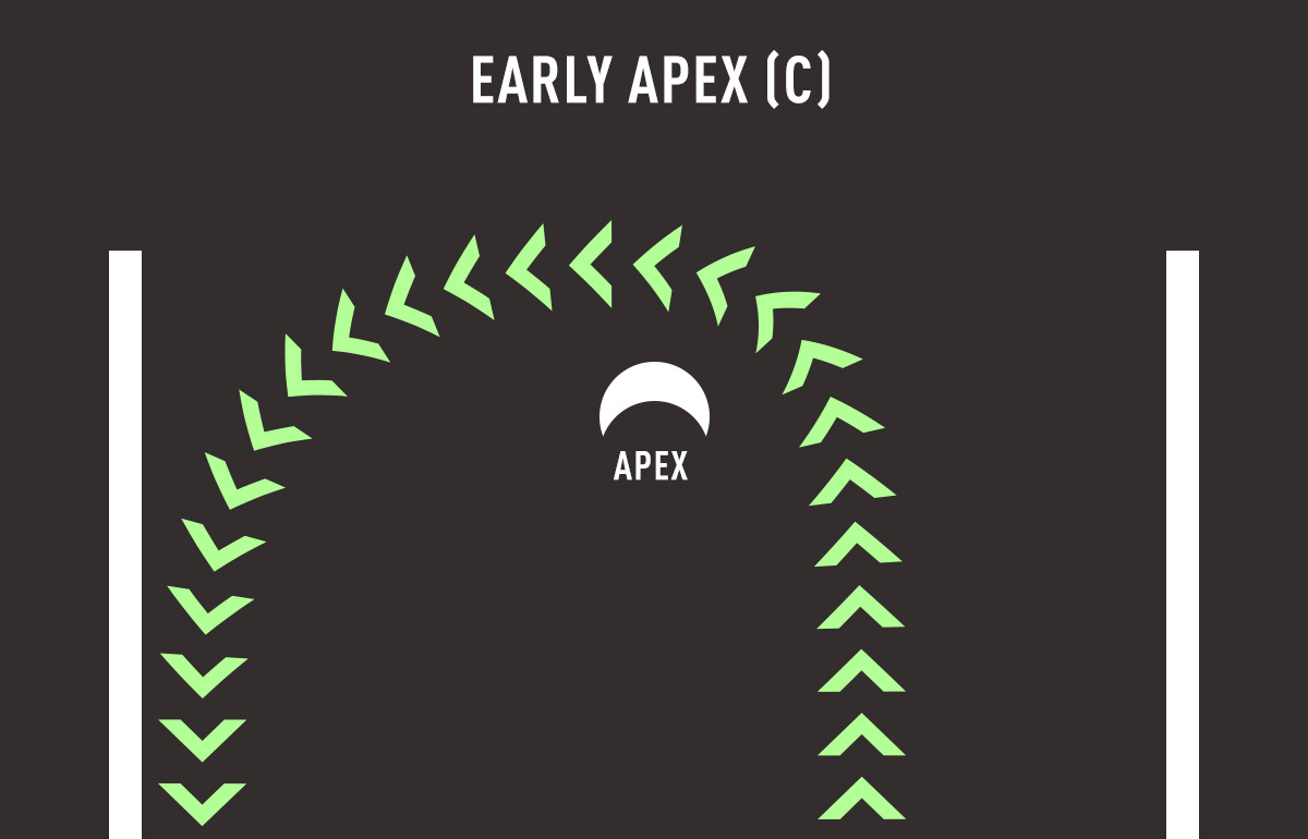

The apex on the early part of your trajectory (C)

A is the standard, usually quickest trajectory on a standard flat corner. You aim to brake evenly on the entry of the corner and maintain corner speed right up to the exit of the corner, this allows you get back to speed quickly using minimal energy. Feather your back brake if needed to control your speed rather than your front – this should prevent it slipping out from under you in muddy or wet conditions.

B is often slightly slower than A, with hard braking going into the corner and turning hard early on, it sets you up to accelerate quickly and take a diagonal approach across the apex towards the exit of the corner. This trajectory is often used when attempting to line up an overtake on a straight after the corner, especially when forcing a rider under pressure to defend their line and take a trajectory closer to C (see below)

C is rarely advised. going into the apex early and tight means you really have to slow down to make it around the corner. You will have to use more energy to get back up to speed on the exit, and often isn’t as smooth. The time this trajectory should be used is when defending a line from another rider. By going in tight you stop your opponent being able to overtake you up the inside. If they are able to do this, chances are they are going to break the momentum of your chosen trajectory and force you to slow down needlessly, therefore it is better to choose this line and to try and keep your opponent on your outer hip of the corner, not allowing them to come up in the inside or around you.
